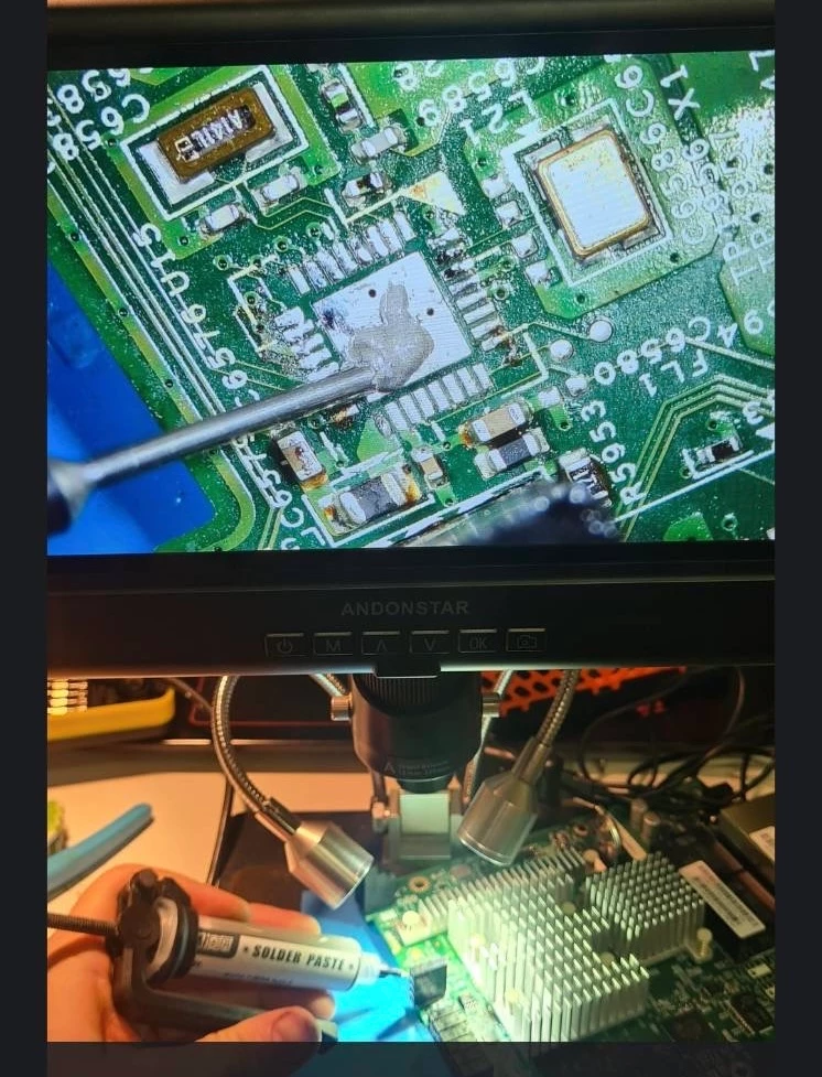

We bought some Firewalls 81F, but unfortunately they all have BLE inbuilt and it is not possible to go through TEMPEST screening. Is it possible to remove inbuilt BLE? Thank you.

evaldas
evaldasAuthor
Explorer
Jan 13, 2025 12:47 PM UTC
We had to remove BLE physically otherwise Lab does't except them and we did it :) IMG_3203.jpeg
