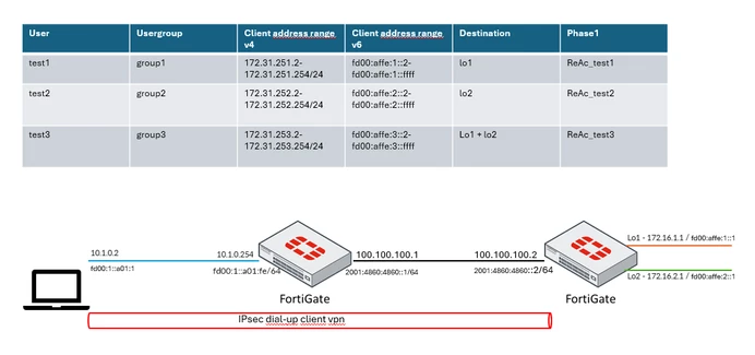

Dear Community,
due to the fact that Fortinet decided to remove the Classic SSL-VPN with 7.6. the first people try to migrate from SSL-VPN to Dial-Up IPsec with mode-config.
To test it for a customer i built following lab:
I was able to get it all running on IKEv2, but somehow eventhough i enabled Split-Tunneling for both ipv4 and ipv6
i receive a default route for both v4 and v6.
Does anyone know the issue and know how to solve it?
Thanks
Mario :)

MarioBerger
Jun 24, 2025 10:08 AM UTC
Hi,
The split-tunnel option i mentioned is "ipv4-split-include" same for v6.
The Objects are  "lo1 address" - 172.16.1.0/24 and "lo1_net" - fd00:affe:1::/64 .

What i'm also unable to do is to use multible Phase1 Interfaces to connect different Usergroups.
No matter what, when i try to connect with user test2 the connection is only triggered on ReAc_test1
