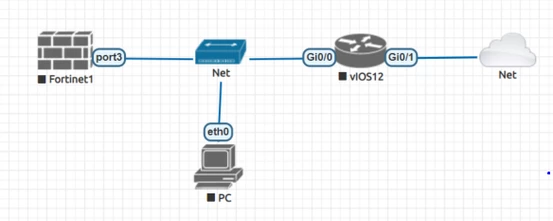

Hi Please see the below diagram. Fortigate-port3, PC-eth0 and router-Gi0/0 (default gateway 192.168.1.1 for fortigate1 and PC to access internet) are in the same vlan. 8.8.8.8 is located at Cloud Net. Now both Fortigate1 and PC can ping gateway 192.168.1.1. but Fortigate1 cannot ping 8.8.8.8 while PC can ping 8.8.8.8. Fortigate config also is listed as below. Did I miss some step?  Thanks

As per firewall configuration shared by you, you have configured a policy route on the firewall which is for the transit traffic. Ping which you initiate from the firewall is a self generated traffic, in order for the self generated traffic to route properly on the firewall we would need a route in the routing-table which can be static or dynamic.
Could you try the below commands and test:
config router static
set gateway 192.168.1.1
set device "port3"
Above commands add a static default route on the firewall.

Right, thank you very much!
