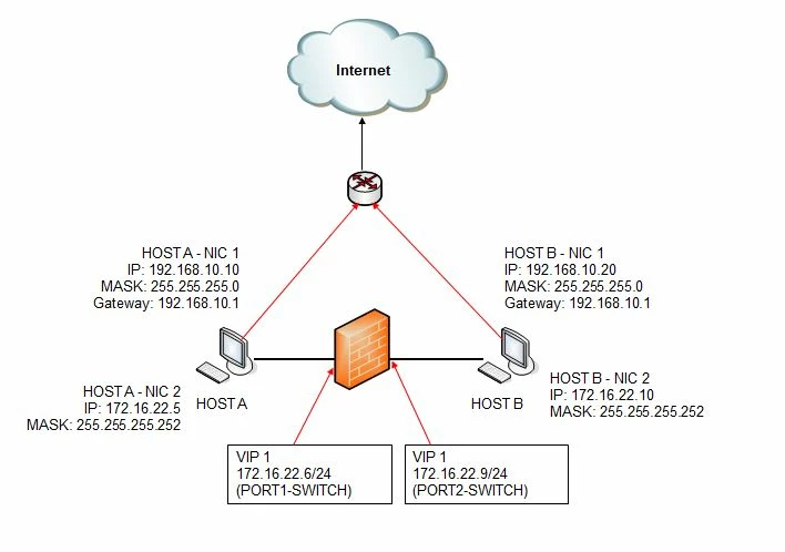

Hi All,
i have 2 workstations in the same network (direct connection between them) and now i need to install firewall FortiGate 50E in between for control.
Any idea how to set that up.
Note: Each workstation has multiple NICs  and one already has default gateway configured so i can't change that.

    Hi there!
    Maybe it's not the same that you already had imagined, but i think this should work:
    It's not entirely necessary to do the exact configuration, but you can try with your fortigate in the same subnet and create a vip with an external IP 172.16.22.6 which forwards traffic to the host b NIC 2, 172.16.22.10 and viceversa. then you must create the policys and start logging.
