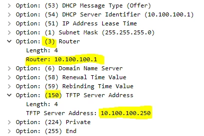

I did some lab tests because I was also curios and it seems that the Router/gateway option can't not be overwritten in the DHCP offer like the other options:
cconfig system dhcp server
config ip-range
  set start-ip 10.100.100.101
  set end-ip 10.100.100.109
  set vci-match enable
  set vci-string "udhcp 1.37.0"
config options
  set code 3
  set type ip
  set ip "10.100.100.254"
  set code 150
  set type ip
  set ip "10.100.100.250"
Translate

Update: If the default-gateway is removed from DHCP server configuration, FGT will send the new gateway as a custom option:
 edit 27
  unset default-gateway
This change will also affect the hosts that are not matching this VCI, if the other hosts can match with a VCI, the default gateway can be sent the same way.
