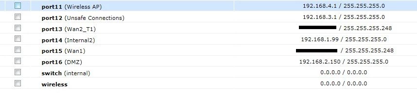

    March 29, 2011
    wmiller or someone who has FortiAP running: I created an interface that I connected the ethernet wire coming from the FortiAP. This is labeled " Wireless AP" in the picture below. Added DHCP and other customizations, then the fortiAP was able to get an ip (192.168.4.110). I then loaded new firmware on the FortiAP and other things, per my previous posts in this thread. That was a few days ago, and now when I look at the interface tab in the webconfig, I see this new " wireless" interface, which I did not create. Sorry for dumb question, but do I need both interfaces, or just one of them? If need both, do I need to customize the new " wireless" interface, if so how? The ethernet from the FortiAP needs to be plugged in, so I dont think I can just delete that interface and move the settings to the auto generated " wireless" interface.
    ejhardin
    March 29, 2011
    Check the " type" it is most likely a " VAP" which is a wireless SSID. It doesn’t have an IP address assigned to it so it is not active. If you don’t need it delete it? Go to the wireless controller tab and check your profiles. You should see the wireless and you can delete it from there.
