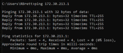

To initiate access, start by pinging the management IP address to verify that the FortiGate is actively listening on the specified management IP. This step helps isolate whether the FortiGate is operational and responsive, assuming that ping is enabled on the management port.
When the endpoint is unable to ping the FortiGate interface IP address, the next step is to determine if the endpoint is in the same broadcast domain using ipconfig /all. In some cases, the IP address must be assigned statically on the endpoint device if DHCP is not enabled on the FortiGate interface or when the endpoint is unable to connect to the internal DHCP server.

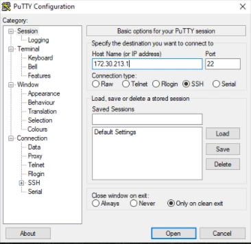

Connect to FortiGate via SSH through PuTTY as demonstrated below, ensuring that SSH is enabled on the management port:
If SSH access is unsuccessful, then use the following article to access the FortiGate via console cable and move on to the next steps:

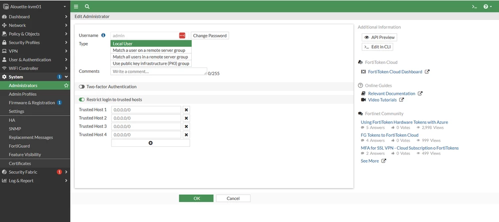

  1. Trusted host configurationIf 'trusted hosts' are configured, the IP address of the computer used for the GUI access must be allowed as a trusted host. A whole subnet can be allowed as a trusted host. By default, trusted host settings are not configured, and administrative access is not restricted to any specific user IP addresses. Sample trusted host configuration:
show
config system admin
    edit "admin-test"
        set trusthost1 10.10.10.1 255.255.255.255
        set trusthost2 192.168.0.0 255.255.0.0
        ...omit
Changing the trusted host configuration:
config system admin
    edit <admin user>
        set trusthost <1 to 10> <ip address>/<mask>
        set ip6-trusthost <1 to 10> <ip6 address>/<mask>
Trusted host settings are defined on an individual admin user basis and are valid for all types of access.
GUI: Define Trusted hosts by going to System -> Administrators.

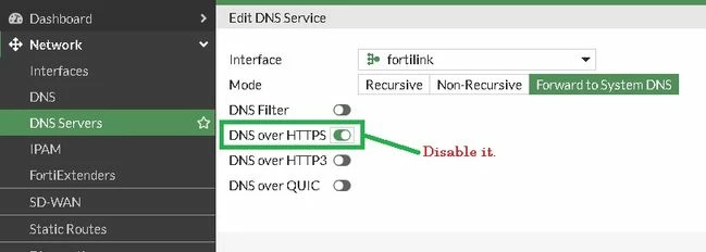

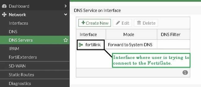

When using port 443 to access the GUI, check if 'DNS over HTTPS' is enabled under the DNS Service of the same interface, as it also uses port 443, which can conflict with the GUI connection.
To check if 'DNS over HTTPS' is enabled, run this command under FortiGate GUI -> Network -> DNS Server -> DNS Service on Interface -> Edit the Associated Interface Entry -> Disable 'DNS over HTTPS':
show full system dns-server | grep doh
    set doh enable
CLI Reference:
config system dns-server
    edit "fortilink" <-- It can be any FortiGate Interface where the user is trying to log in.
        set doh disable <--

Try using a custom Admin Access port (for example: 8443, 4443) to avoid any port conflict for the default HTTPS port 443.
