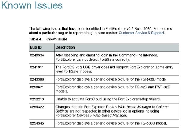

    Haven't say I ran into this before with Fortigate devices, though reading the patch notes for 2.5 it looks like there are some known issues if you are using that version of FortiExplorer.
    But have you tried any of the following troubleshooting steps...
    - Switch the USB cable to another USB port on your management computer.
    - Test USB connection/FortiExplorer on another computer.
    - Remove/reinstall the USB drivers via the the FortiExplorer set up.
    - Try a different version of FortiExplorer.
    - Try searching for/installing 3rd party USB drivers.
    Personally, and it looks like the 60D supports it, I would just use a console cable to connect to the console port on the front, and use Putty.  Or if you have already configured the interface ports on the fgt, just connect to that interface via Ethernet cable (assuming you have enabled admin access on the interface).
