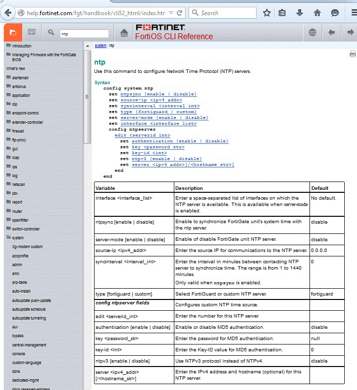

    Default fortigate settings will only show what is configured differently from the default value; use "show all" instead of "show" if you want to see what other options that are configurable for a setting; also some feature set is not showable until an option is first enabled (e.g. set status enable.).
    In your case, I think you will want to configure the server mode type/IP and enable the authentication options.

    You can't just decrease a NTP stratum value, a value of 16 means your NOT IN SYNC, so  the nexus will never establish sync. I would 1st make sure you diagnostic shows your have an establised clock discipline 1st and then double check the ntp config on the nexus.
    IMHO  &  from my experience, NX_OS has created big issues  in NTP vrs IOS or IOS-XR. I've experience major issues with NX-OS sync to a  local stratum clock  GM from symmetric TP5500  where everybody else sync'd correctly to the  GM ( stratum 1 ).
    Here's a post  I placed for a client of mine and pertains to  3500s but our 7K didn't have any issues btw, since this post date, we have upgraded our  NX3548 numerous times.
    http://socpuppet.blogspot...-6x-how-to-enable.html
    If you have the means to use ntpq , i would query the local fortigate 1st and then look at the NX switches, if you have others ( systems ) maintaining clock sync with no issues,  than look at the NX-Switches.
