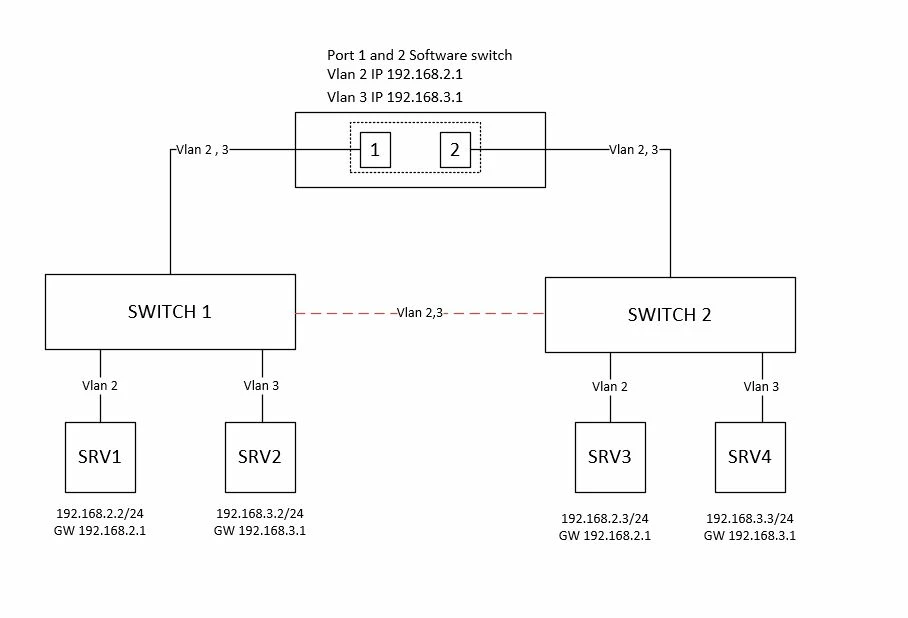

Hi all,
I have 2 switches connected to 2 fortigate interfaces that forms a software switch. This software switch routes some Vlans that terminates at these ports. Both ports share layer 2 and 3 parameters. When traffic from different vlans reaches firewalls, I route traffic between then with rules.
I won't go into the details of this design, but the switches are in different locations and need to share networks/vlans.
With software switch, servers from both switches can directly reach the gateway with direct connections to the firewall. In some cases, I move virtual servers between locations (using a dedicated Fiber cable) and with this topology servers works with same network configuration in both sites.
I would like to connect a new cable between switch 1 and switch 2 to bypass traffic between same vlans but, if I do that, I'll form a layer 2 loop. (Red line diagram). What I would like if it's possible is:
1)Use 2 different ports in firewall to can route same networks/vlans (north south).
2)Add a new connection to bypass east-west traffic between same vlans (witouth routing). I don't want in any case to use spanning tree.
Is there any way to do that? Changing the software switch to another type of configuration would not be a problem.topology.JPG
I attach a symple diagram so you can better understand the topology. I know this is probably not possible, but I prefer to confirm with you. I can't form a LAG cause switches doesn't forms an MCLAG or stack and is not possible to form it with them.

Adding the wire between Switch1 and switch2 will without any doubt create a loop in the network.
It is simply not possible from my understanding, there's no avoiding this without unplugging a port, using STP or keeping a port down.

fortimaster
Explorer III
Nov 21, 2024 3:47 PM UTC
That's what I thought. Thanks for your help.

STP is also not supported for Software switch. This is not the right way to configure this setup but you can try by blocking Intra-switch traffic in the software switch configuration (I haven't tested and don't know the exact behavior).

Nov 21, 2024 4:34 PM UTC
That's just that I want... I will look into it.
