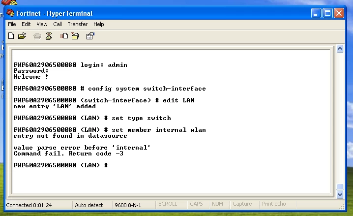

Hello! I am in the process of reconfiguring my FortiWifi 60A from scratch (factory reset) and having some issues. I' m trying to create a software switch so that my WiFi and Internal are the same network. Article that I' m following: http://kb.fortinet.com/kb/microsites/search.do?cmd=displayKC&docType=kc&externalId=FD33206&sliceId=1&docTypeID=DT_KCARTICLE_1_1&dialogID=31796920&stateId=0%200%2031798859 Can anyone shed some light on what im doing wrong? Appliance: FortiWifi 60A Firmware: 3.00-b0744(MR7 Patch 6)

    Just a quick update.. I was able to finally make a software switch combining " internal" and " wlan" to a new interface called " LAN" . Unfortunately, I' m unable to get out to the net :( Here are the steps I took to create it: 1. Create your WiFi network (SSID/Password) - You' ll have no control over this after you combine interfaces. 2. Delete all firewall policies pertaining to the interfaces that you are trying to combine (in my case - internal and wlan) 3. Delete dhcp server listed under internal interface These are the commands I used to create the " Software Switch" (I' ve highlighted the CLI commands that differ from the guide): config system switch-interface edit <New network that you are creating> set type switch set member internal wlan set vdom root config system interface edit <New network that you are creating> set ip 192.168.1.99 255.255.255.0 set allowaccess ping https ssh set type switch set vdom root After I created that, I logged into the web interface to create the dhcp server for the combined interface. The guide CLI commands are not correct and i could not figure it out. Kept getting errors using this CLI " setdns-service default" (Unkown Action). Now onto the policy... I created a policy " LAN (internal/wlan combined) -> wan1 (internet connection) and vice versa. What am i missing to get me out to the net?
