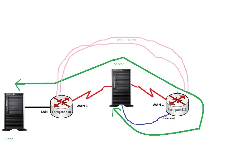

    Hey guys, I' ve changed my topology a little bit,but encountered a problem.Now i have a computer between the 2 FG(which is also my server side) The idea that i had was: i' ve configured an ipsec tunnel between the 2 fg so that all traffic from the internal intf to the wan intf passes through the ipsec tunnel. My question is if i can apply wan optimization over the ipsec tunnel. I am asking this because i don' t seem to get the wan opt tunnels up. I' ve used active passive arhitecture with transparent mode enabled. My topology is smth like this: client - fg1 --wan1-- server --wan1-- fg2 ................................. |_____internal_| So the server is between the FG' s and has also a connection to the fg2 (in order for the traffic to arrive somewhere ) Like i said, can i apply wan opt over the ipsec tunnel?If so(and hope so),i must be missing something oblivious. Thanks a lot

    I don' t totally understand your topology, but yes you can apply WAN Optimization over the IPSec links. Disregard the parts in the guide about using encrypted WAN Optimized tunnels and just set un-encrypted ones between local IPs on either side of the IPSec tunnel.

    @mbrowndcm: That was the link that i used to configure my ipsec and wan optimization.I forgot to mention in my previous post. I' ve managed to set up the wan optimization tunnels,but it seems that it works only for peer-to-peer and not for active-passive(don' t know why) @veechee: my topology is a little weird due to lack of equipment(2 fortigates and 2 computers)Here is a picture of the topology.The green line is how traffic passes from the client to the server , the pink is the ipsec tunnel, red is for the wan ports and the blue and black are for the lan ports. On my server i' m now running a program (countertrace) that receives packets and sends them to user space, where it adds a number of hops(thus increasing latency).Hope this is a good enough wan simulation.Moreover, i' m using smokeping for measuring delays and latency.
