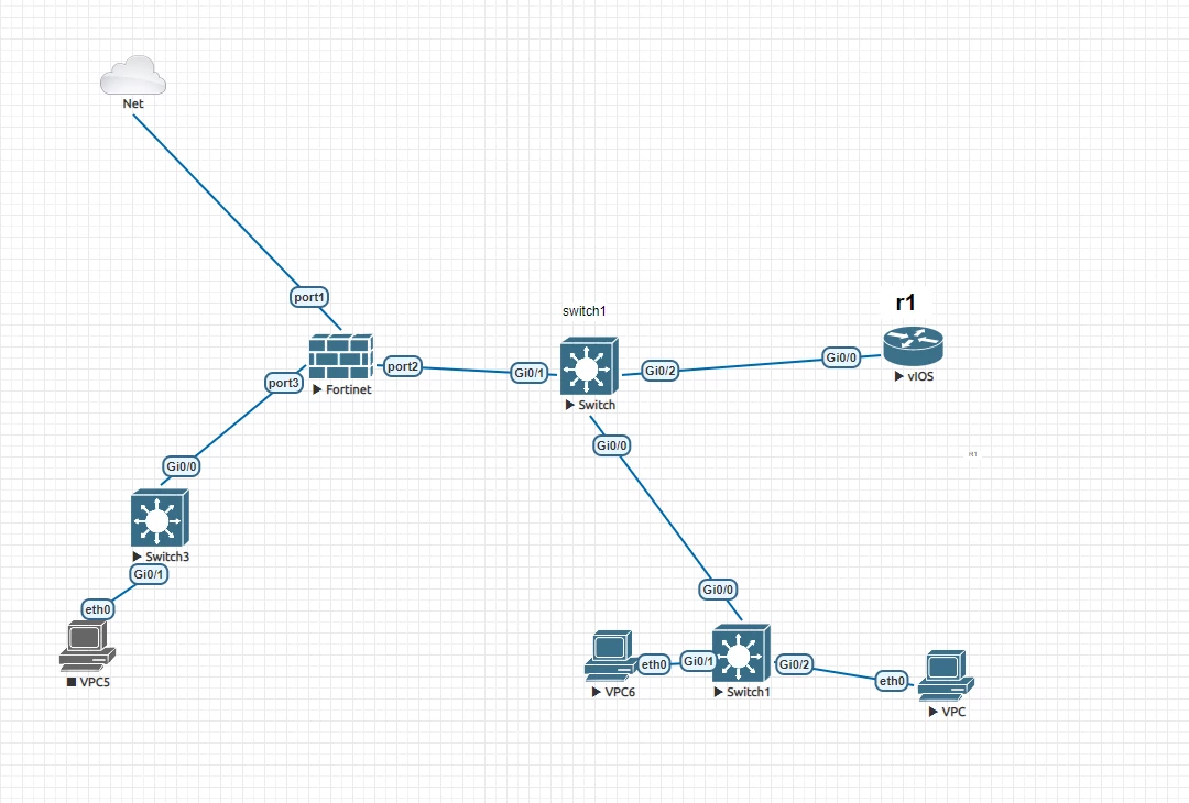

I have the below topology . Here R1 is  conigured router on stick . switch 1 is L2
R1

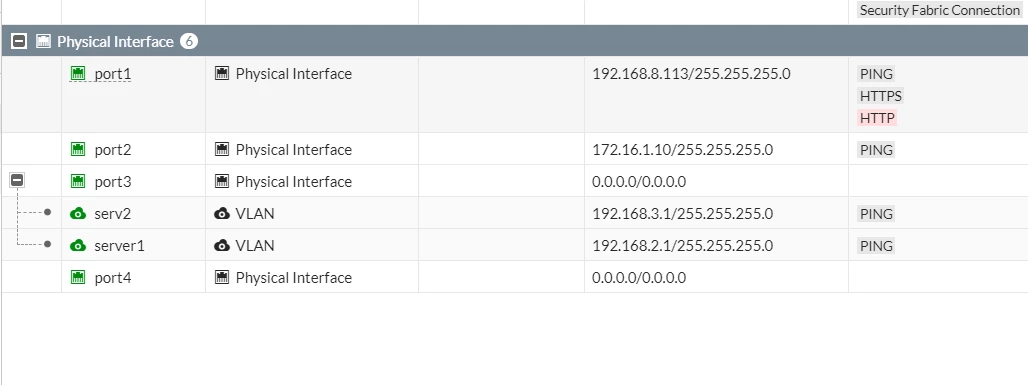

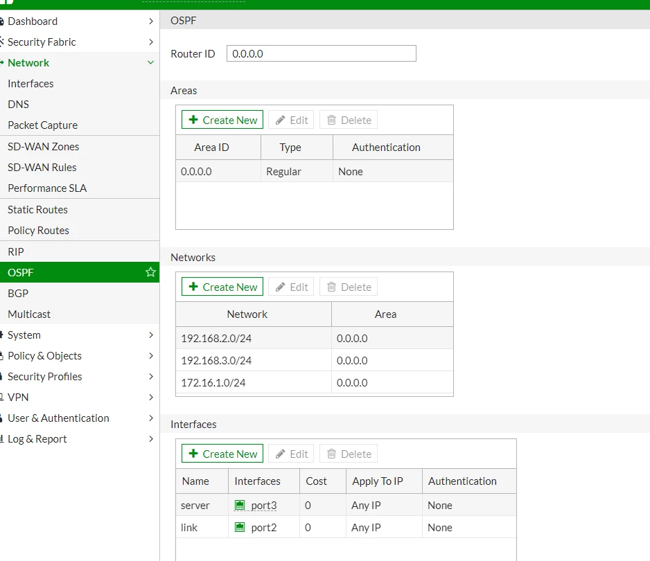

The purpose is r1 want to learn all the network from fortigate .but it does not forming neighbourship
R1#sh ip ospf neighbor
R1#
please help
1 reply
Toshi_Esumi
December 20, 2021
Not a routing problem, but switching problem. Cisco side is on VLAN 111, while FGT side is not VLAN tagged. You can't even ping between 172.16.1.9 and .10 each other.
