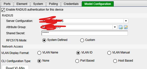

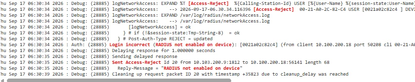

I have 2 cisco switch managed by fnac and i add the 3rd cisco switch.
After i configure the dot1x on the 3rd switch then the authentication is rejected with below error
What mean of RADIUS not enabled on device? IN the inventory the RADIUS was enabled.

caunon
Sep 17, 2026 1:15 AM UTC
Kindly ensure that the configuration selectors are configured correctly in FortiNAC.For detailed instructions, please refer to the following the link as following.
https://docs.fortinet.com/document/fortinac-f/7.6.7/support-for-radius-only-devices/418014/step-6-create-configuration-selectors

HS08
HS08Author
Valued Contributor
Sep 17, 2026 1:17 AM UTC
Existing cisco device is not use any configuration selectors
