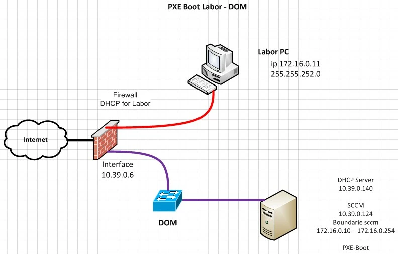

hey guys, after a couple of days i work it out the intervlan routing. works, but now i have a problem with the PXE boot request... i attached the snifer file...can someone look at it? i think i have a problem with the return path... [link=]https://www.dropbox.com/s/anyslyxuubqtohj/sniffer_2.pcap[/link] the pxe boot option like this.. set next-server 10.39.0.124 set ntp-service specify set option1 67 ' 736d73626f6f745c7838365c7764736e62702e636f6d' set option2 66 ' 31302e33392e302e313234' thanks guys rafael

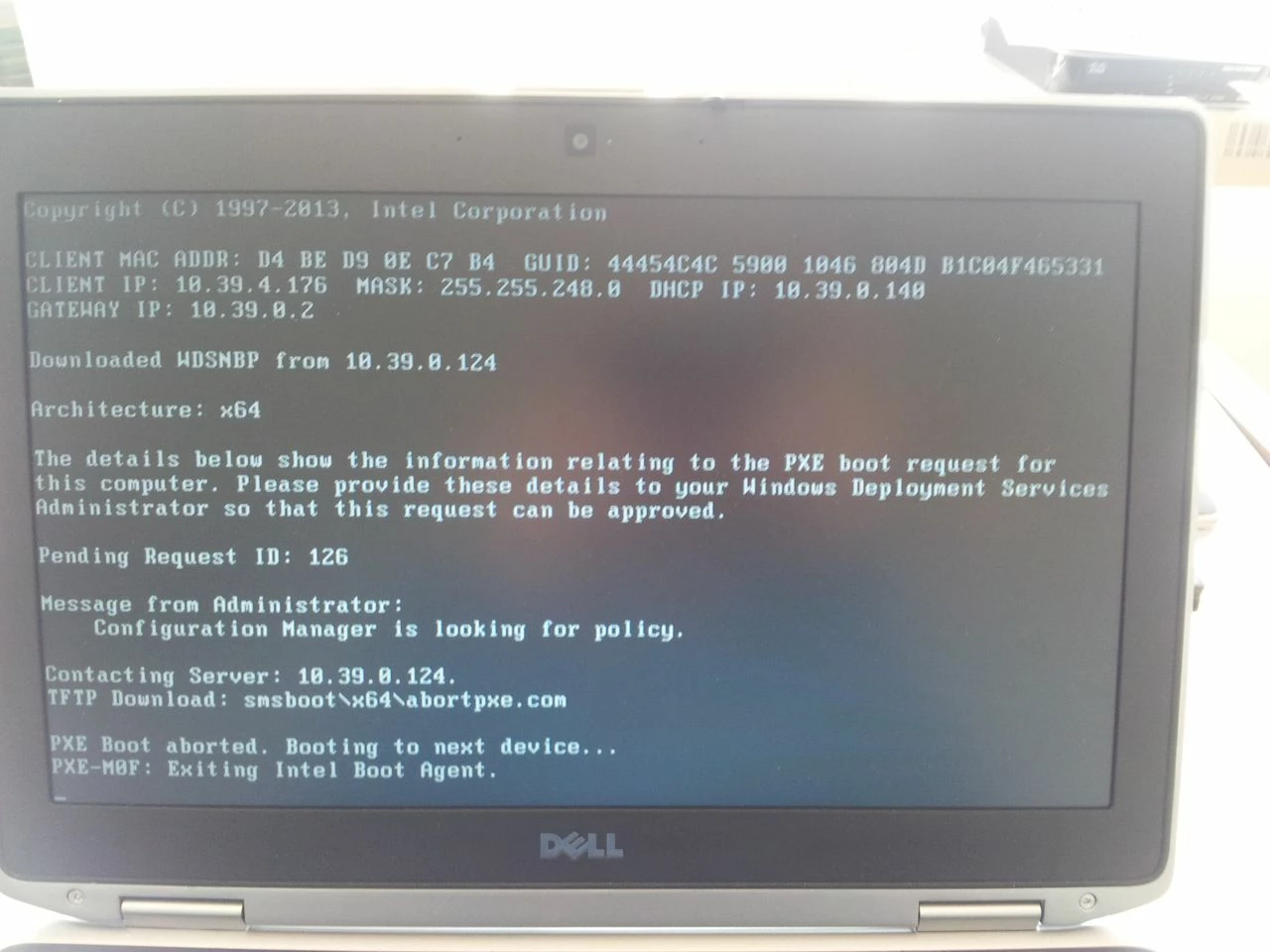

    and the two pxe-boot screenshots from both networks...

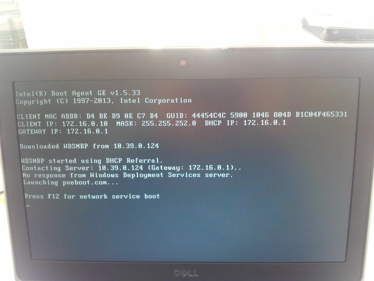

    and the other network
