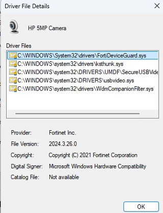

@lol I got the same results as Rowdy and have the same questions. I'm not sure how this altitude order helps us at all. When I look at the drivers being used by the camera none of them are minifilter. The ones I'm seeing are: ksthunk.sys, SecureUSBVideo.dll, usbvideo.sys, WdmCompanionFilter.sys, and FortiDeviceGuard.sys
When I use any 3rd party laptop with our systems, they work fine. On those machines the active drivers are the same, minus the FortiDeviceGuard.sys. This makes me believe the issue lies with the "FortiDeviceGuard.sys" file.

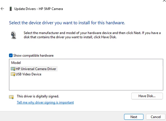

After 2.5 years - I'm seeing this issue as well. Not sure if it's a FortiDeviceGuard, Windows, or HP issue but starting my search here first.  I work for an MSP, and end users of one specific co-managed customer are reporting this problem.
We've observed inconsistent camera issues for users on HP ProBook 450/460 G8/G10/G11s w/ FortiClient 7.2.8.1140 and Windows 11 Enterprise.  Users' cameras either won't turn on at all, turn on after a 5-10 minutes, sporadically freeze on a single frame, or sometimes show a blank white box where their camera feed should be.
The issue primarily affects Microsoft Teams, and only on devices with the specific settings listed above.  None of our Bitdefender GravityZone customers experience this issue, including customers with the VPN-only FortiClient.
The FortiEMS deployment is managed entirely by the customer's internal IT, so all I want is some pointers on monitoring/logging the issue - preferably without needing an end user to run a FortiClient Debug log in the background throughout their entire workday.
Originally the Switch to the UVC Driver listed on HP's website resolved the issue (especially on the G8 devices) but now G11 users are reporting the issue even with the universal driver.Error submitted by user while I was writing this post.Error submitted by user while I was writing this post.Before chaning the driverBefore chaning the driverChanging driver from HP Universal Camera Driver to USB Video DeviceChanging driver from HP Universal Camera Driver to USB Video DeviceUSB Video Device Driver DetailsUSB Video Device Driver Details
