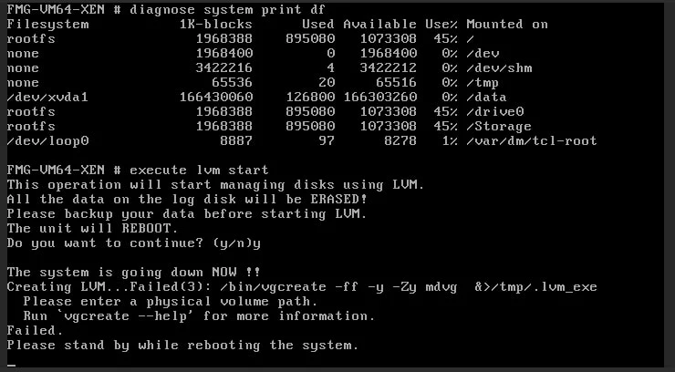

Hi All,
We have issue to start LVM on Fortimanager OS (see below pictures). Do you know what could be missing?
System Information
Host NameFMG-VM64-XEN Serial NumberFMG-VM0000000000Platform TypeFMG-VM64-XENHA StatusStandaloneSystem Time Mon Sep 02 01:57:15 2019 PDT Firmware Versionv6.2.1-build1121 190718 (GA)

The only solved i can found for this problem is to downgrade to  v7.2.2-build1334
it solve this problem
Serial number:FMG-VM0000000000
Creating LVM...Done.
Formatting hard disk (/dev/mdvg/mdlv, ext4)... Done.
Upgrading sample reports...Done.
Initialize file systems...
New version: v7.2.2-build1334 branchpt1334 230201 (GA)
