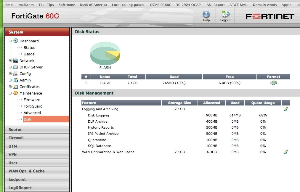

    I find that interesting, one of my clients has an FG60C with FW 4.2.8. I installed an 8GB flash drive to the USB port, then setup file logging space for the various log types. I just recently had an event that the log file was 75% full, so I increased the allotted space to handle more traffic. In the webui traffic and event windows it also gives you the option to view memory buffer or disk. So unless I am dreaming, FW 4.2.8 lets you log to external disk! Are we discussing the same thing or something else? ....JIM....
    The FortiGate 60C has 8 GB of flash memory, and is called " Disk" in the GUI, i bet its that you see.

    If that is the case, why would Fortinet provide USB Disk formatting capability on the devices that have USB jacks? I have included a screen shot of the page that shows the disk allotment. In the Administration Guide for Version 4.0MR2 see formatting USB Disks on page 198. I will have to do further evaluation of the USB flash disk to see if it actually has any other files on it besides the configuration backup file. I guess that would provide more proof one way or the other. If you can' t put the logging files on a USB flash disk, why have flash disk capability??? I have an FG60B too, but I need to update the firmware to 4.2.8 or later and try the USB disk on it and see what happens... ....JIM....
    Translate
    Carl_Wallmark
    Apr 27, 2012 3:16 PM UTC
    Thats because USB drives are used for storing configuration and firmware, nothing else. The flash on your screenshot is the built-in " disk" on the 60C.
