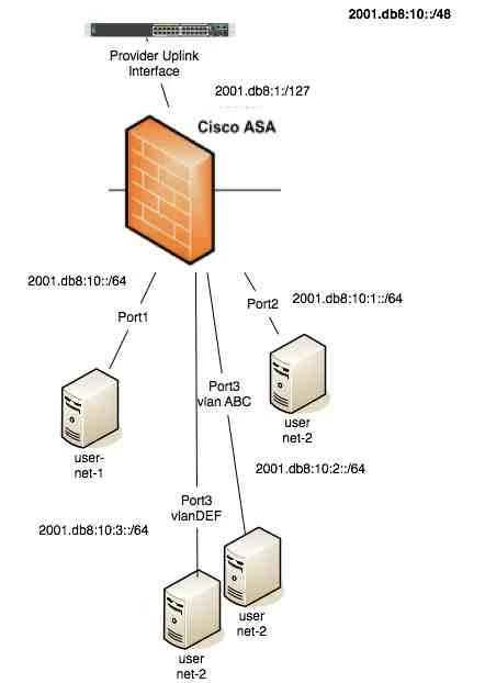

    What are you trying todo? Do you have a topology drawing of the inside/outside interfaces and where the autconf clients are located at? Some how & from what your describing tells me , SLAAC is not what you want. SLAAC is trivial and a straight forward configuration

    I can try and explain what I am after. I have a /48 prefix assigned by my ISP. This /48 prefix can be routed to me by putting it straight on the vlan that connects to me, or by using a /64 link net. This link net is not a part of my initial prefix. Right now it is setup using the link net configuration. I would prefer for the prefix to be assigned to my vlan directly though. And having the fortigate sit on a static ipv6 address for management. While my internal units automatically picks up their ipv6 configuration using slaac. I hope this was a better explanation of what I wanted. Thanks again for the help.

    Why don' t you assign a /64 out of the /48 on the WAN link and divided the reminding 64k minus1 /64 for your internal vlans with SLAAC on the vlan interfaces. You can assign multiple /64 prefixes on one interface if required and you can have multiple ipv6 address per interface. Very simple see diagram;
