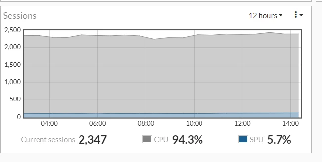

Hello Dears
I am noticing high CPU on GUI for my Firewall 201E while on Cli it is show me it is ok
ok cli as shown on below :
DR-201E-1 # get system performance status
CPU states: 0% user 0% system 0% nice 100% idle 0% iowait 0% irq 0% softirq
CPU0 states: 0% user 0% system 0% nice 100% idle 0% iowait 0% irq 0% softirq
CPU1 states: 0% user 0% system 0% nice 100% idle 0% iowait 0% irq 0% softirq
Memory: 4057360k total, 1742700k used (43.0%), 1557556k free (38.4%), 757104k freeable (18.7%)
Average network usage: 1782 / 1886 kbps in 1 minute, 2933 / 3061 kbps in 10 minutes, 2686 / 2846 kbps in 30 minutes
Maximal network usage: 9361 / 9399 kbps in 1 minute, 19665 / 19402 kbps in 10 minutes, 44234 / 43515 kbps in 30 minutes
Average sessions: 2367 sessions in 1 minute, 2381 sessions in 10 minutes, 2388 sessions in 30 minutes
Maximal sessions: 2389 sessions in 1 minute, 2476 sessions in 10 minutes, 2598 sessions in 30 minutes
Average session setup rate: 18 sessions per second in last 1 minute, 18 sessions per second in last 10 minutes, 16 sessions per second in last 30 minutes
Maximal session setup rate: 36 sessions per second in last 1 minute, 59 sessions per second in last 10 minutes, 59 sessions per second in last 30 minutes
Average NPU sessions: 128 sessions in last 1 minute, 130 sessions in last 10 minutes, 130 sessions in last 30 minutes
Maximal NPU sessions: 132 sessions in last 1 minute, 138 sessions in last 10 minutes, 140 sessions in last 30 minutes
Virus caught: 0 total in 1 minute
IPS attacks blocked: 0 total in 1 minute
Uptime: 28 days,  6 hours,  13 minutes

Hello @MustphaBassim ,
You can review this article about CPU usage graphics. This graphic is related to sessions. And this graphic says it processed of total sessions %94.3 on CPU, %5.7 on SPU.
https://community.fortinet.com/t5/FortiGate/Technical-Tip-Understanding-the-meaning-of-Session-CPU/ta-p/251417
