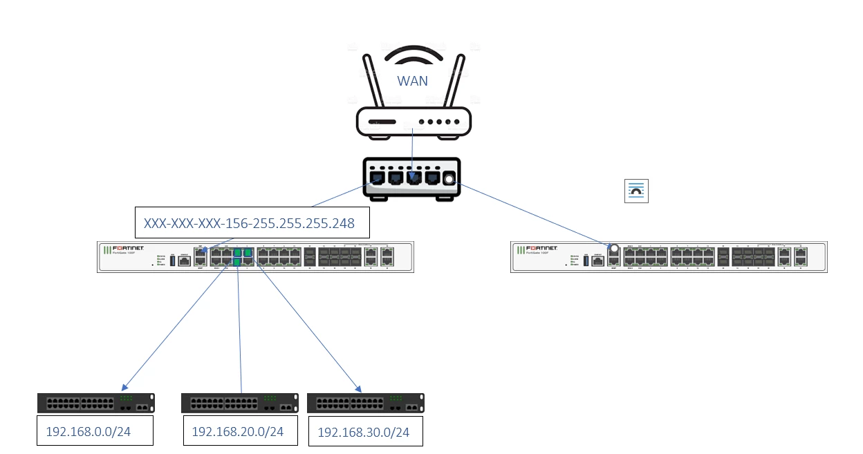

Good morning everyone. Attached is the current sceneHA.png. We have now acquired a second Fortigate 100F. The idea is to configure the two in active-passive HA (High Availability). I have some doubts. 1) Can the WAN be the same? 2) How do I connect and where do I connect the three doors of the second Fortigate? 3) The 3 ports of the first Fortigate are configured as DHCP Servers, will they continue to work?

Hi Fabio,
Yes, this is correct and expected to work.

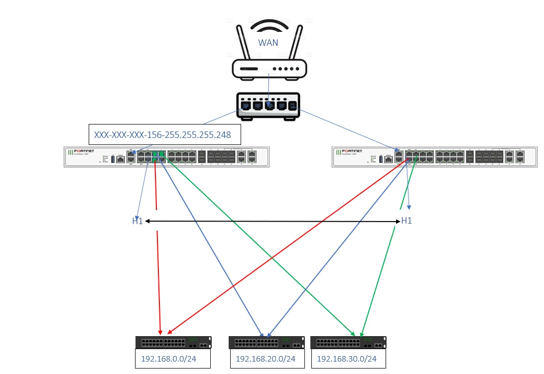

Woww... Great, thanks for the quick reply srajeswaran. Two more little doubts. 1) I don't have a Layer 2 switch, can it still work? 2) I connect ports H1 and H2 equally to each other, right?
srajeswaran
February 27, 2023
Yeah, the same ports from both units need to connect to the same LAN subnets. The LAN segments in diagram shows switches, is that so? If so, you just need to add one port to the connection towards the new FGT unit.

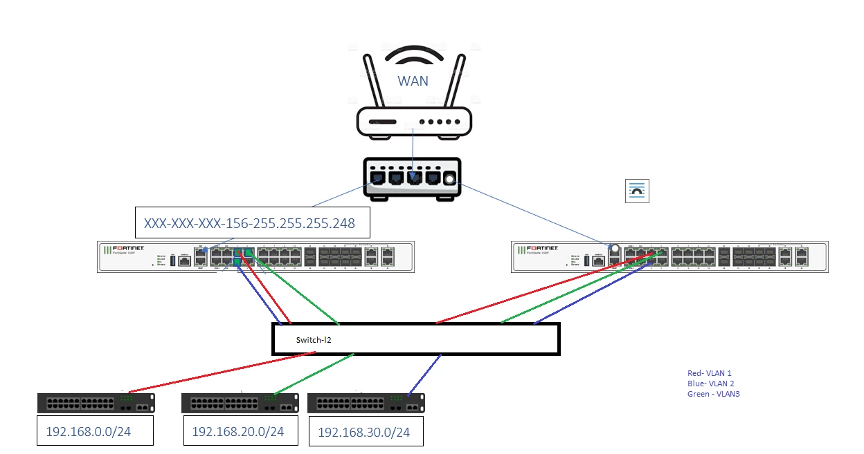

I was wrong, actually the scheme should be this, precisely because I don't have a layer2 switchHA.png
srajeswaran
February 27, 2023
Hi Fabio,
