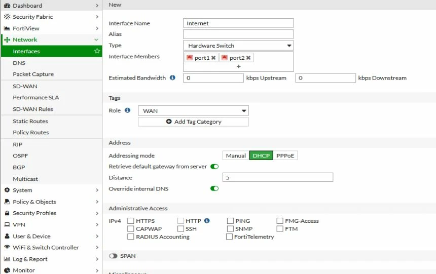

Sure.
You'll have to create a virtual or hardware switch (depending on the hardware) on your fortigate. And connect the Internet and your Recorder to this 'virtual switch'.
Than both your fortigate and your recorder are connected to your modem.
This would probably mean some decent amount of work to reconfigure everything on your Fortigate. Getting an additional 5-port switch might be an easier option
