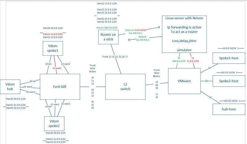

I think , i just came up with brilliant idea how one can simulate sdwan/advpn just with one physical firewall (in my case it is 60F :)
so i've splited firewall in several vdoms:
spoke1-vdom
spoke2-vdom
hub-vdom
and just with one link to L2 switch and a bunch of vlans i was able to create advpn cloud.
check screenshot for details.
