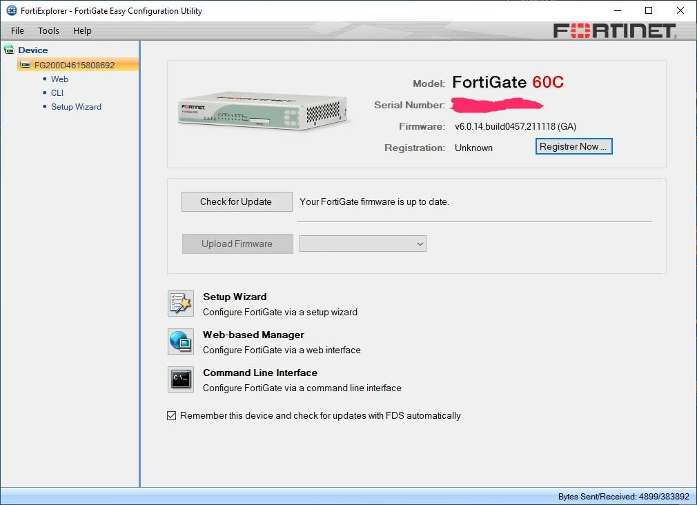

Hello everybody,
i have fortigate 200D, i connect it to Computer with usb cable because i have no connection with lan cable.
Forti-explorer shows 60C, and i enter username: admin, password is empty, whatever i use web, cli, setup wizard or putty it says wrong credentials!
what should i do?

the FortiExplorer tool has been discontinued for a few years now, there may be compatibility issues that are interfering, for example (that could also explain why a FortiGate 200D is identified as a 60C model).
