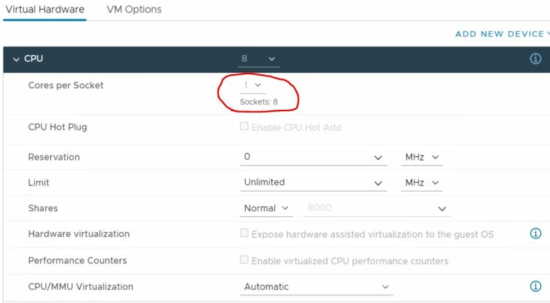

Hi,
On Vmware ESXi platform is present a FAZ with version 7.2.4
Premise, on the vcenter where I am operating the cpu and ram resources are available I have performed similar operations on other Fortinet vm's (Fortigate, ect)
Under edit settings -> cpu
This is the situation
Has anyone had a similar problem is it possible to have to have 2 cores each with 8 sockets ?
I don't think it's a fortinet license issue or the vm image installed on the vm.
I thank you for your attention and look forward to your opinion.
Best Regards
Best answer by Mandalorian
Hi,
I inform you that we have found the cause of what was reported.
This limitation is due to the hardware version of the vm hosting the FAZ.
Updates will follow, in the meantime thank you for your support
Best Regards

Hello @Mandalorian ,
FortiAnalyzer license doesn't have any restrictions about resources.  If you have resources you can give them.
However, FortiGate has different license types. You need to configure how many resources your license includes.
Also, you can review this document about the minimum requirements for FortiAnalyzer.

Hi @ozkanaltas
Thanks for reply, if you tell me that the faz vm has no licensing restrictions in this respect the only thing to think about is the image file installed on the vm.

Hi,
Best Regards
"This is the way"
Mandalorian
Explorer III
March 28, 2024
Hi,
I am just writing to let you know that after hardware upgrade of the vm hosting FAZ we were able to assign 16 cpu to the machine.
As a precautionary measure, a snapshot of the vm and backup of the FAZ config had been done.
This activity in our case did not result in any impact to the FAZ.
Best Regards
