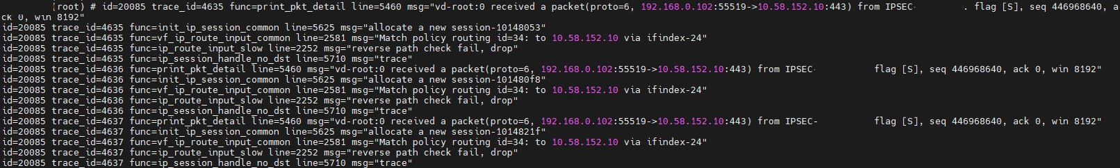

We're trying to connect 2 sites with an VPN IPSEC. with the tunnel up and working. we have the next issue:
Scenario:
Triying to connect 192.168.0.102 --> 10.58.152.10
Having the following issue:
Anyone can help please?

Hi,
Please provide the output for the following:
get router info routing-table details 192.168.0.102
get router info routing-table details 10.58.152.10
Once you share these outputs, we can clarify what might be going wrong here.
Thank you.

Routing table for VRF=0
Routing entry for 192.168.0.0/22
Known via "connected", distance 0, metric 0, best
* is directly connected, VLAN-A.
FGT01 (root) ## get router info routing-table details 10.58.152.1
Routing entry for 10.58.152.0/24
Known via "static", distance 10, metric 0
10.58.152.1, via port14
* is directly connected, port14

Hi,
If you could see that there is no route for 192.168.0.102 via IPsec Interface, that is why you are seeing reverse path check.
You are receiving the traffic from source interface IPsec and you should also have a route that points at the Ipsec interface for 192.168.0.102.
Please add a static route and it should fix this.

Hi,
You can also check the following article for details: https://community.fortinet.com/t5/FortiGate/Technical-Note-Details-about-FortiOS-RPF-Reverse-Path-Forwarding/ta-p/190100

July 6, 2022
Finally solved restoring backup :)
