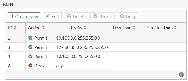

I have prefix list to filter which prefix will be send to azure.
Previously ID no 4 is not exist and i can see in the advertise route only showig 10.103.0.0/16 and 172.30.30.0/24
FW01 (Internet) # get router info bgp neighbors 10.201.0.4 advertised-routes
VRF 0 BGP table version is 43362, local router ID is 10.103.103.103
Status codes: s suppressed, d damped, h history, * valid, > best, i - internal
Origin codes: i - IGP, e - EGP, ? - incomplete
Network Next Hop Metric LocPrf Weight RouteTag Path
*> 10.103.0.0/16 10.210.0.103 100 32768 0 i <-/->
*> 172.30.30.0/24 10.210.0.103 100 32768 0 i <-/->
Total number of prefixes 2
But when i add ID number 4 above why the fgt still advertise 2 prefix and not advertise 10.105.0.0/16?

I just realized that prefix list will be execute from lower id to higher id. The picture i post earlier should be sort by ID.
So after bgp to that peer cleared then only prefix 10.103.0.0/16 will be advertised.

Toshi_Esumi
Jan 23, 2026 7:01 AM UTC
Do you have "set soft-reconfituration enable" in the neighbor configuration? If so, try "exe router clear bgp ip 10.201.0.4 soft out" a couple of times. Otherwise, you might need to reset the session (take the neighbor down and bring it back up).
Toshi

Toshi_Esumi
Jan 23, 2026 4:20 PM UTC
No. They're examined from the top of the list regardless of the ID. If you go into CLI then delete the ID#1 prefix list, the GUI should show only #3, #4 and #2. Then if you go back and configure,
config router prefix-list
  edit [prefix-list_name]
    config rule
        set prefix 10.103.0.0 255.255.0.0
        unset ge
        unset le
the ID#1 prefix would be added to the end of the list. So now GUI would show in the order  #3, #4, #2, and #1. Then #3 would be examined first and #1 last.

HS08
HS08Author
Valued Contributor
Jan 24, 2026 2:53 PM UTC
But if we look at https://community.fortinet.com/t5/FortiGate/Technical-Tip-How-FortiGate-Match-Routes-on-the-Prefix-List/ta-p/316238 then "the prefix matching is performed based on Sequence ID". This same with what i facing.
