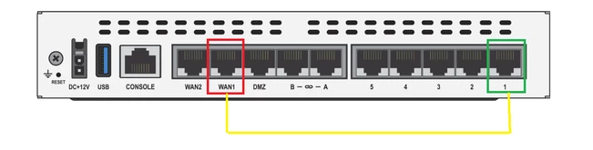

If a port on FortiGate seems to be dead or non-functional, a loopback test is the best way to consider as part of troubleshooting. This ensures and eliminates the issue from the other end device connecting to that interface and isolating the test with the Firewall itself.
In this example, consider WAN1 as the port that seems defective, and port1 is the healthy port.
Additionally, check the LED light ON/OFF and physical connections and cables are in good shape.

Connect a new or working network cable to the working interface on the firewall, such as port1 from this example, and connect the other end of the cable to the non-working interface, such as WAN1.
Once the connection is made, if the interfaces still do not come up, perform an HQIP test by leaving this connection until the HQIP test is done.
