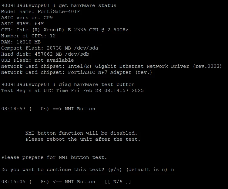

The command 'diagnose hardware test button' can be run to confirm if the button is NMI or Reset (for example: in 101E, the button does not have a 'RESET' label, but it has a reset function, not NMI).
For example:
  1. On FortiGate-101E:
Test Begin at UTC Time Tue Dec 26 13:07:05 2023
13:07:05 ( 0s) ==> Reset Button
Please prepare for reset button test.
Do you want to continue this test? (y/n) (default is n) n
Test skipped by user.
  1. On FortiGate-401F:
Some hardware models of FortiGate have an NMI pinhole, which is used for interrupting the controller. When the NMI button is pressed, particular information about the kernel and CPU is displayed on the console session.
The generated information is very useful for investigating a kernel panic that occurs, resulting in a halting state or troubleshooting system freezing when the system hangs and cannot be interrupted.

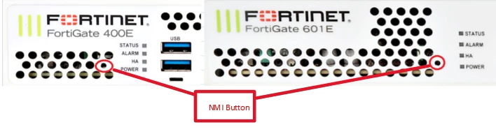

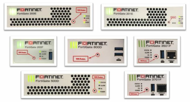

The NMI button is typically located on the front left side of the FortiGate. The position of the NMI button on some hardware models of FortiGate has been shown in the following pictures as a reference:
