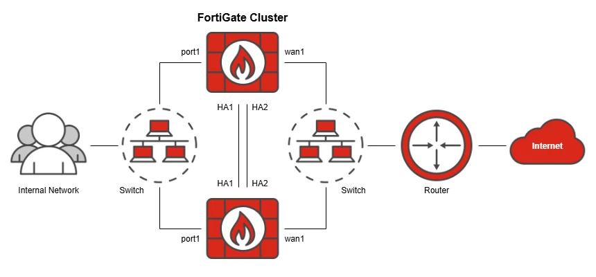

This article describes a list of resources related to High Availability (HA) on the FortiGate. This feature is implemented using the FortiGate Clustering Protocol (FGCP) and allows the FortiGate to minimize disruption/downtime to the network and provide redundancy in case one of the FortiGates experiences an issue.
FortiGate.
The FortiGate Clustering Protocol (FGCP) is a proprietary HA solution that allows two to four FortiGates to negotiate the creation of a single logical 'cluster'. Each FortiGate in the cluster must be the same model, have identical licensing, and must be running the same firmware version and revision. Cluster members must also run matching operating modes (Transparent or NAT mode) and have the same hardware configuration (such as the same number of hard disks).
When operating in an FGCP cluster, all members will share a synchronized configuration. Some device-specific configurations are not synchronized, such as device hostname, HA override and priority values, and interface settings related to HA reserved management interfaces. Traffic will generally flow through the HA Primary unit only, though in some specific scenarios, an Active/Active cluster can redirect traffic from the HA Primary to an HA Secondary unit for processing.
