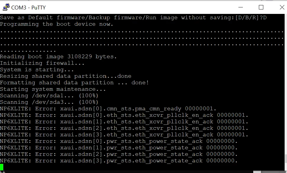

FortiGate (NP6, NP6lite, & NP6XLite models).
This error usually appears in the console output when the image is loaded to boot up after a manual or automatic reboot.
Restarting system.
FortiGate-101F (02:28-02.13.2020)
Ver:05000020
Serial number: FG101FTK20007904
CPU: 1400MHz
Total RAM: 4 GB
Initializing boot device...
Initializing MAC... nplite#0
Please wait for OS to boot, or press any key to display configuration menu......
Booting OS...
Initializing firewall...
System is starting...
NP6XLITE: Error: xaui.sdsn[0].cmn_sts.pma_cmn_ready 00000001.
NP6XLITE: Error: xaui.sdsn[0].eth_sts.eth_xcvr_pllclk_en_ack 00000001.
NP6XLITE: Error: xaui.sdsn[1].eth_sts.eth_xcvr_pllclk_en_ack 00000001.
NP6XLITE: Error: xaui.sdsn[2].eth_sts.eth_xcvr_pllclk_en_ack 00000001.
NP6XLITE: Error: xaui.sdsn[3].eth_sts.eth_xcvr_pllclk_en_ack 00000001.
NP6XLITE: Error: xaui.sdsn[0].pwr_sts.eth_power_state_ack 00000000.
NP6XLITE: Error: xaui.sdsn[1].pwr_sts.eth_power_state_ack 00000000.
NP6XLITE: Error: xaui.sdsn[2].pwr_sts.eth_power_state_ack 00000000.
NP6XLITE: Error: xaui.sdsn[3].pwr_sts.eth_power_state_ack 00000000.

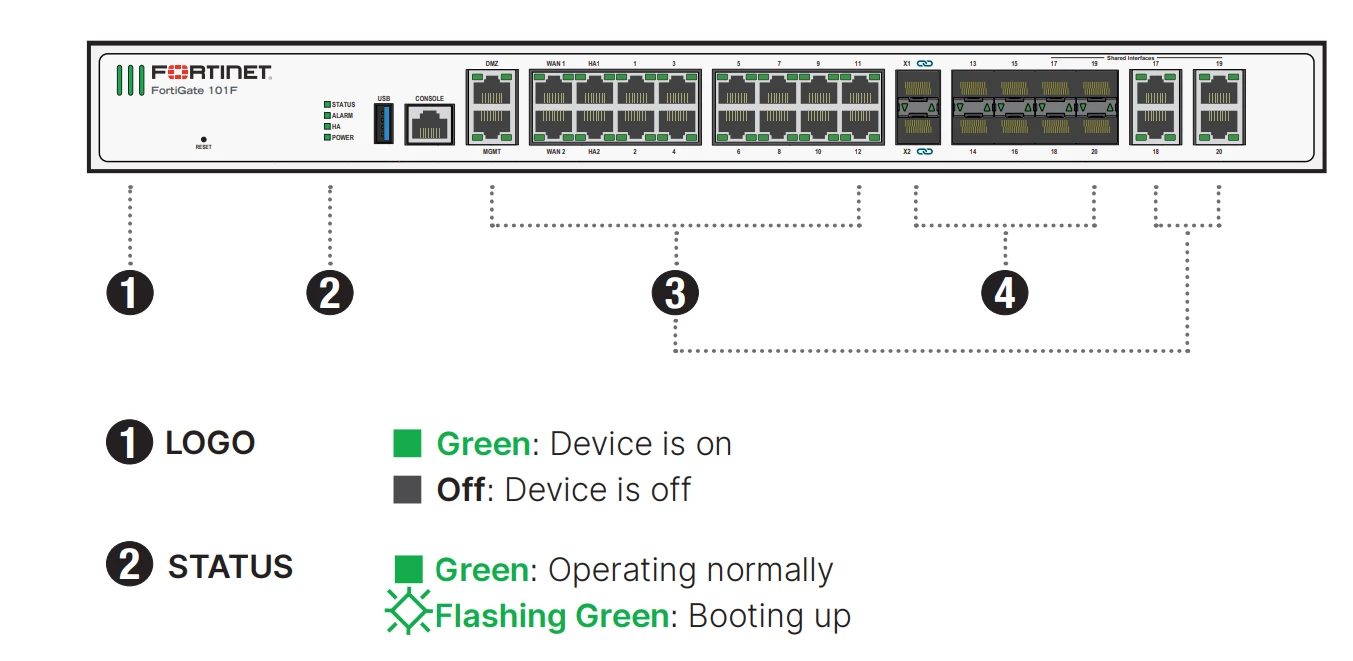

Below is the FortiGate 101F's front.
  • Before doing a hard reset, take a valid backup.
  • After doing this If the issue persists, open a ticket with Fortinet Support.
  • Attach the console output to the ticket.
