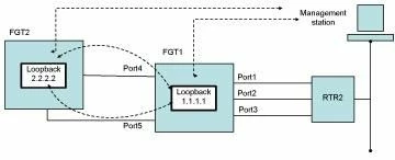

BGP peering and Management access scenario:
The loopback interface is seen from the routing table as a connected interface:
FGT1 # get router info routing-table all
C       10.0.0.2/32 is directly connected, loopback
  • FGT2 and FGT1 can establish an iBGP peering to their respective loopback interface via Port4 or Port5 (routing and firewall policies must permit).
  • The Management station has only single IP addresses for FGT1 and FGT2, that can be accessed from any interface and routed by RTR2 (routing and firewall policies must permit).
