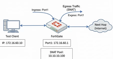

Description This article describes a scenario where Central SNAT fails to translate the source IP of traffic that enters and exits the FortiGate through the same physical or logical interface. This behavior is typically observed in 'same-interface routing' scenarios where global redirection settings bypass the firewall policy engine.
Scope FortiOS.
In specific network topologies, traffic may need to be routed back out of the same interface it arrived on. If Central SNAT or Policy-based NAT is required for this traffic, the FortiGate must process the packet through its policy engine (iprope) to evaluate NAT rules.
In this scenario, the Test Client’s traffic must be NATed to a specific IP pool address before being forwarded to the destination, even though both the ingress and egress occur on port1.
When traffic enters and exits the same interface, the FortiGate may skip the iprope_central_nat_check if the global setting allow-traffic-redirect is enabled. This setting is designed to allow same-interface forwarding efficiently, but it can cause the firewall to bypass the policy lookup required for NAT.

Scenario 1: 'allow-traffic-redirect' is ENABLED (Failure):
config system setting
    set allow-traffic-redirect enable
With this enabled, the FortiGate optimizes same-interface traffic by bypassing policy evaluation. The sniffer shows the source IP (172.16.60.10) exiting the interface without translation:
FGT # diagnose sniffer packet any 'host 4.2.2.2 and icmp' 4
port1 in 172.16.60.10 -> 4.2.2.2: icmp: echo request
port1 out 172.16.60.10 -> 4.2.2.2: icmp: echo request <----- No SNAT applied.
Scenario 2: 'allow-traffic-redirect' is DISABLED (Success).
    set allow-traffic-redirect disable
When disabled, the FortiGate is forced to process the traffic through the firewall policies, triggering the Central SNAT table lookup.

It can be concluded that whenever such an issue is encountered, the traffic redirect setting must be disabled in the global configuration to ensure that Central SNAT is applied to traffic on the same interface:
