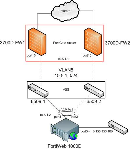

In this example configuration, port1 and port2 are used for LACP and port3 is the management interface.
Console access will be needed to make the changes.
FortiGate <---> FortiWEB service network : 10.5.1.0/24
FortiGate: 10.5.1.1
FortiWEB: 10.5.1.2
Management network: 10.150.150.0/24
Gateway: 10.150.150.1
FortiWEB: 10.150.150.100
Topology:

- The following policy route is the key to ensuring that FortiWeb responds to management traffic using port3.
- Such management traffic arrives at the FortiWeb on 10.150.150.100.
- Therefore, when FortiWeb replies it will use 10.150.150.100 as its source IP.
- That source IP will match the following policy route and determine both gateway and outgoing interface.
