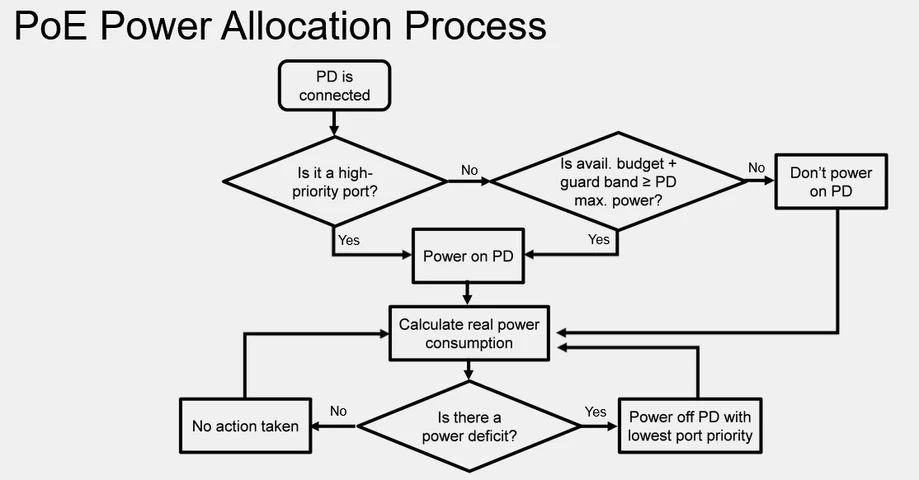

Description This article describes a flowchart on how POE power allocation process works when any PD is connected to the FortiSwitch.

Refer to the below flowchart to understand POE power allocation process:
