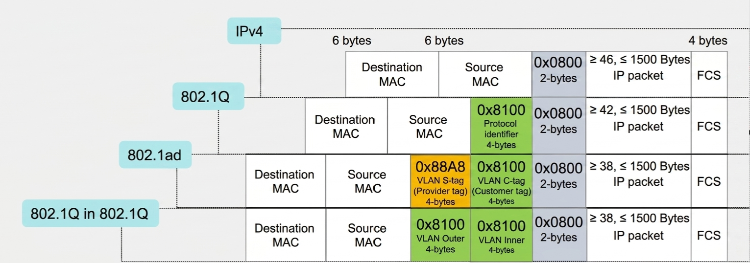

This article describes the Ethernet-type frames that can be used.
FortiSwitch.

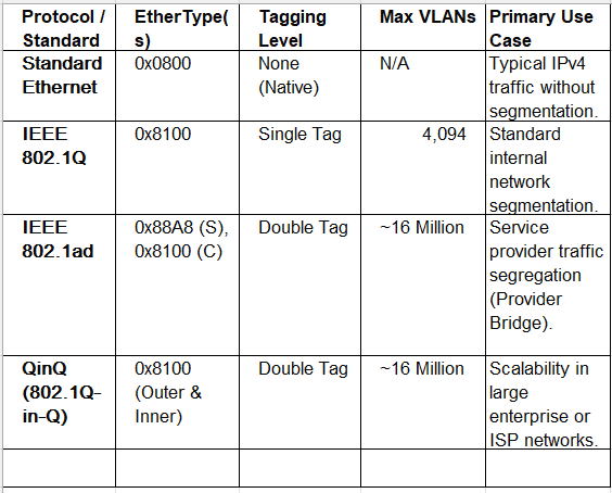

Layer 2 domains have alternative Ethernet types, and the use depends on the VLANs for different services required. This table shows the Ether Types and use cases:
In this section, the VLAN combinations are represented by their different categories:
