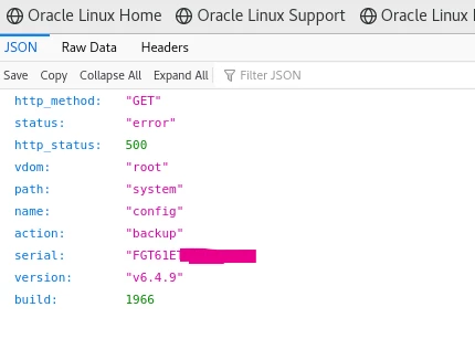

An error is encountered when trying to perform a upgrade or take a backup of config:
  1. When performing an upgrade, the following error is seen.
  1. When taking a backup:
"http_method":"GET",
"status":"error",
"http_status":500,
"vdom":"root",
"path":"system",
"name":"config",
"action":"backup",
"serial":"FG101ETKXXXXXX",
"version":"v6.4.4",
"build":1803
Through TFTP, the following error will be seen:
Failed to allocate file Command fail. Return code -26
Solution: The error message http_status:500 was indicative of a disk read/write operation issue. Rebooting FortiGate will resolve issue.
