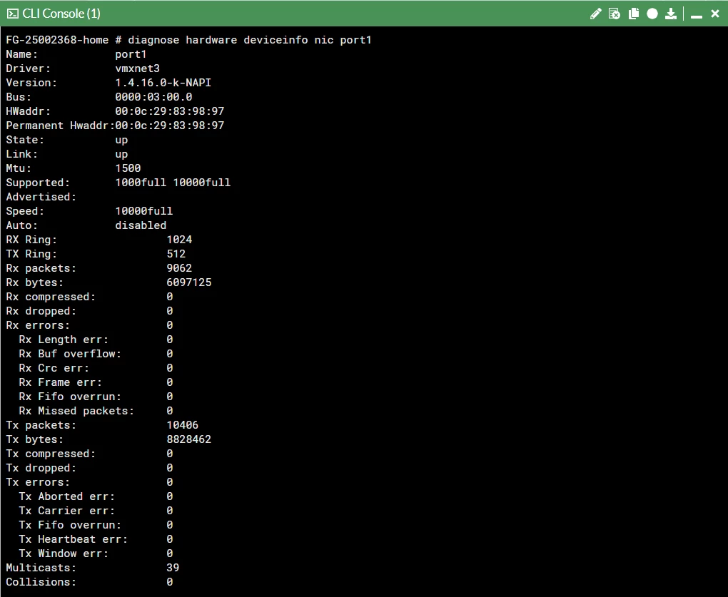

The counters and their meaning describe what can be seen when using the CLI command:
diagnose hardware deviceinfo nic <interface name>
Â
Using port1 as an example.
