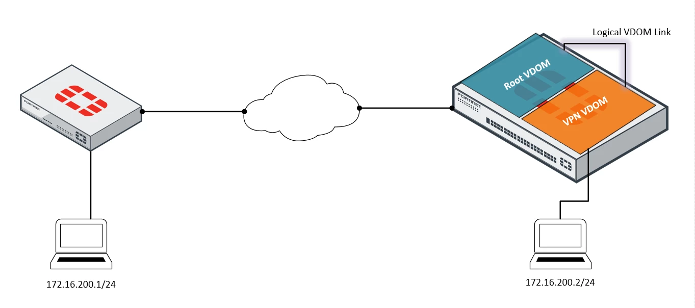

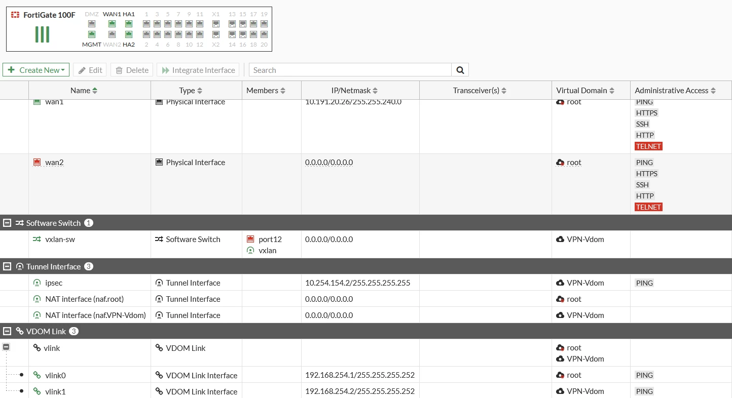

On the first setup, a Software VDOM link on the second FortiGate is used at the right to route traffic between the Root VDOM and the VPN-Vdom:
Due to a limitation on the Software VDOM Link, the VXLAN traffic will not work properly.
If a ping is initiated from host 172.16.200.1 to host 172.16.200.2, and then the traffic is sniffed on both FortiGates, everything will look fine on the first FortiGate, but on the second, the ARP request will not be forwarded properly.

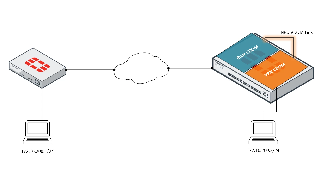

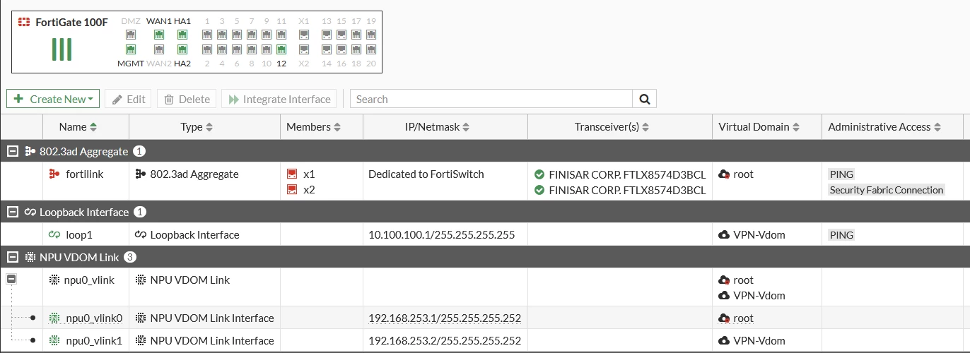

If the configuration is switched on the second FortiGate to an NPU VDOM link, end to end communication will be established:

18.193556 vxlan in arp who-has 172.16.200.2 tell 172.16.200.1
18.193560 port16 out arp who-has 172.16.200.2 tell 172.16.200.1
18.193561 vxlan-sw in arp who-has 172.16.200.2 tell 172.16.200.1
18.194615 port16 in arp reply 172.16.200.2 is-at 00:74:61:63:29:01
18.194618 vxlan out arp reply 172.16.200.2 is-at 00:74:61:63:29:01
47.245781 vxlan in 172.16.200.1 -> 172.16.200.2: icmp: echo request
47.245784 port16 out 172.16.200.1 -> 172.16.200.2: icmp: echo request
47.250965 port16 in 172.16.200.2 -> 172.16.200.1: icmp: echo reply
47.250968 vxlan out 172.16.200.2 -> 172.16.200.1: icmp: echo reply
48.239543 vxlan in 172.16.200.1 -> 172.16.200.2: icmp: echo request
48.239546 port16 out 172.16.200.1 -> 172.16.200.2: icmp: echo request
48.240281 port16 in 172.16.200.2 -> 172.16.200.1: icmp: echo reply
48.240283 vxlan out 172.16.200.2 -> 172.16.200.1: icmp: echo reply
49.239837 vxlan in 172.16.200.1 -> 172.16.200.2: icmp: echo request
49.239840 port16 out 172.16.200.1 -> 172.16.200.2: icmp: echo request
49.240456 port16 in 172.16.200.2 -> 172.16.200.1: icmp: echo reply
49.240459 vxlan out 172.16.200.2 -> 172.16.200.1: icmp: echo reply
50.239503 vxlan in 172.16.200.1 -> 172.16.200.2: icmp: echo request
50.239506 port16 out 172.16.200.1 -> 172.16.200.2: icmp: echo request
50.240343 port16 in 172.16.200.2 -> 172.16.200.1: icmp: echo reply
50.240346 vxlan out 172.16.200.2 -> 172.16.200.1: icmp: echo reply
