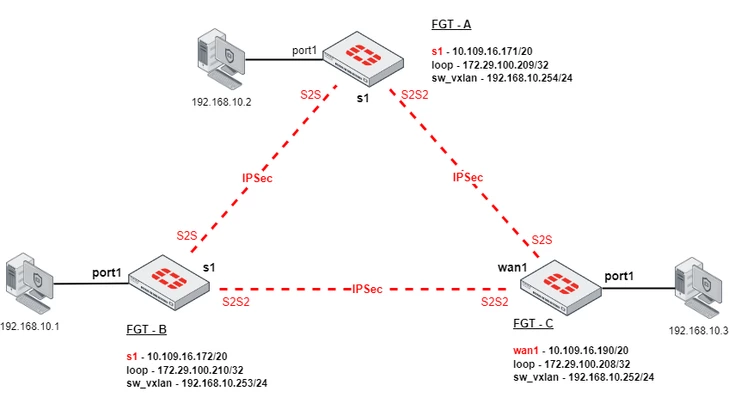

This article describes how to configure VXLAN over IPsec for multiple remote-ip per VNI using a loopback interface.
FortiGate.
Diagram:
Use below CLI commands:
