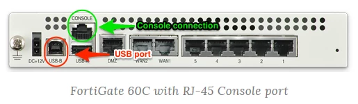

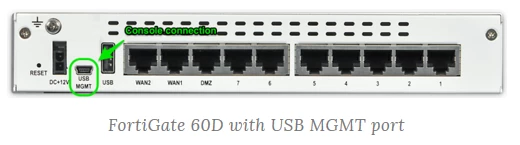

This article describes that some FortiGate models are shipped without the standard RJ-45 or RS-232 serial console port that a lot of users are familiar with. In its place is a USB port that is designed to work with FortiExplorer and a USB cable instead of the Terminal session and console cable.
Other models work with FortiExplorer, but those models use a USB port that is part of the FortiGate in addition to the console port. In those units, accessing the FortiGate through FortiExplorer at the BIOS level is not possible. The firmware has to be up and running before a CLI interface is available.
Because of the limitation in those models, there has been some concern about how to manage certain scenarios with the USB MGMT Console port-only models:

There are some FortiGate models with only the USB MGMT Console port, that have a BIOS that allows access through the USB connection to the BIOS.
USB Connection Requirements
Connecting to a FortiGate unit that does not have an RJ-45 or serial console port requires the following:
  • USB cable (USB-A to Mini-USB).
  • Ethernet cable if you are going to be setting up a TFTP session.
  • FortiExplorer software, installed.
Initial setup
Use the USB cable to connect the computer to the USB MGMT Console port. Open FortiExplorer. Connect the FortiGate to a power supply.

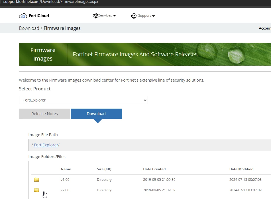

FortiExplorer.
The FortiExplorer software is no longer maintained. It is available for download at Firmware Images.
The TFTP example described will work with the 2.2.x versions of FortiExplorer for Windows, but not with the Mac software of the same version. To install via TFTP using a Mac make sure that you have a current copy of the software. It has been tested successfully with version 2.3.1052.
