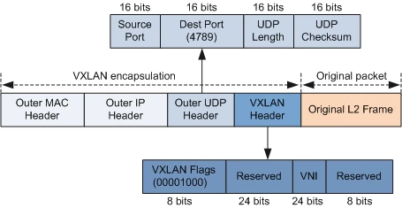

The maximum MTU (Maximum Transmission Unit) of a VXLAN interface is determined by the MTU of the underlying physical or logical interface. This MTU value is reduced by the overhead introduced by the VXLAN encapsulation. To calculate the effective VXLAN MTU, use the following formula:
VXLAN MTU = Underlying Interface MTU - VXLAN Encapsulation Overhead
VXLAN Encapsulation Overhead:
VXLAN encapsulation adds several layers of headers to the packet, which contribute to the overall overhead:
  • Outer Ethernet Header: 14 bytes (This header encapsulates the entire VXLAN packet, providing the outer MAC address details without VLAN tagging; add 4 bytes if VLAN tagging is used).
  • Outer IP Header: 20 bytes for IPv4 or 40 bytes for IPv6.
  • Outer UDP Header: 8 bytes.
  • VXLAN Header: 8 bytes.
Total Overhead:
  • IPv4 Encapsulation: 50 bytes (54 bytes with VLAN tagging).
  • IPv6 Encapsulation: 70 bytes (74 bytes with VLAN tagging).
