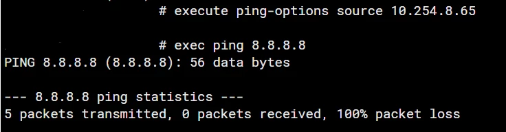

Description This article describes about the issue where users are unable to ping public servers (for testing) using ping-option source from LAN interface.
Scope FortiGate, all Firmware.
Consider the following network, where the LAN facing interface with IP address 10.254.8.65 is trying to reach public servers.
LAN<-->(10.254.8.65) FGT (96.90.29.254)<-->WAN ---> (8.8.8.8)GoogleDNS
execute ping-options source 10.254.8.65
execute ping 8.8.8.8
PING 8.8.8.8 (8.8.8.8): 56 data bytes
--- 8.8.8.8 ping statistics ---
5 packets transmitted, 0 packets received, 100% packet loss
# Timeout
Connection lost.
  • This is an expected behavior as the pings are local traffic generated from FortiGate and are also from a private IP 10.254.8.65.
  • To confirm if a host in the LAN network can reach the public servers (reach the internet), it is recommended to test it from one of the host itself and not from the firewall.
  • For the traffic going through the firewall, it will hit the firewall policy and get NATed but not for the local traffic generated from the FortiGate.
  • Local traffic does not match an IPv4 firewall policy.
  • Here basically it is being told to the  firewall to generate a ping with a private IP as source out through a wan port hence it'll be dropped as no private IP address will be routed.
  • Testing from the firewall itself is not ideal, at least not from a private IP as a source.
  • Generating traffic form a host should work and the packets can be traced to see the route.
  • When tested from a public IP, that is sourcing the WAN IP and pinging a public IP should work.
If one wonders, it works when the source option is not chosen because when one pings 8.8.8.8, automatically public WAN IP is used as the source and hence the pings will be successful.
So this is an expected behavior and not an issue with the FortiGate.
To reset the ping-options use below command:
exec ping-options reset
