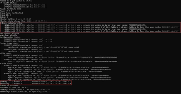

Start with the following console command:
get system ha status
Pay attention to the information close to the top, which shows any warnings related to the cluster.
Notice the last 4x HA historical events with timestamps, where the reasons for the last HA transitions are provided (there will be more events shown in the next command).
Check if the cluster is 'in sync' and when the last synchronization happened.
Check the heartbeat interface counters for errors or status changes like 'down' interfaces. Close to the bottom, confirm the Primary and Secondary units' roles by the hostname.

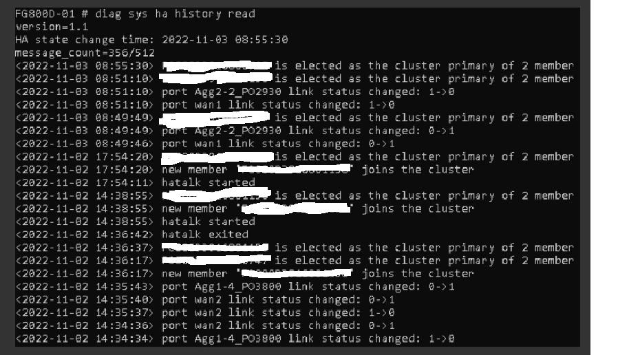

Check the history of the election process by running the following command:
diagnose sys ha history read
The history above is limited to 512 entries and is persistent across reboots. Each unit keeps track of its own history of events, and while it can be cleared manually, it will override the oldest events.
Pay attention to 'link status changes' where 0=down and 1=up might trigger the election algorithm for monitored interfaces. LAG and aggregated interfaces are deemed 'down' if all LAG members go down.
The LAG interface status behavior can be adjusted with the following interface settings: min-links.

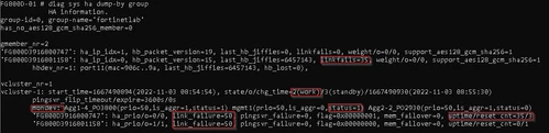

Check Link monitor, interfaces, and Age by running the following command:
diagnose sys ha dump-by group
Notes:
  • linkfails=35 will show the total number of 'down' interfaces on that serial number.
  • The second highlighted line (2(work)) is another easy way to know if this unit is Primary state=2 or Secondary state=3.
  • mondev: will show brief information for each monitored device and its status (1=up and 0=down).
  • The link_failure count can also be checked from 'diagnose sys ha dump-by vcluster'.
  • Cluster uptime is the last information seen, and (uptime cnt=35, reset 3) will show the cluster uptime along with the number of times it was reset. Uptime is reset when there is a mondev status change.
When the system boots up and any monitored interfaces are down, the link_failure count will increment by 50 for each interface in the 'down'. This value is not configurable. For instance, if there are 3 interfaces currently down, link_failure will equal 150. If both HA nodes boot up at the same time, the election process will take place, and the system with the lowest link_failure count will become preferred as the Primary.
While the cluster might select the unit that has the fewest monitored and failed interfaces while booting up, Age (uptime) will be only considered after the 'ha-uptime-diff-margin' (AKA 'grace time').
Age and link_failure will only trigger cluster transitions after the cluster boots up and has been up for more than the ha-uptime-diff-margin (which is 300 seconds, or 5 minutes, by default).
If the interface monitor's list is updated during cluster operation, the link_failure count will be reset to reflect the current monitored interface status (UP or Down). For instance, if there were 3 Down interfaces before (link_failure=150) and 2 are removed from monitored interfaces, then link_failure=50, as there is still one down interface being monitored.

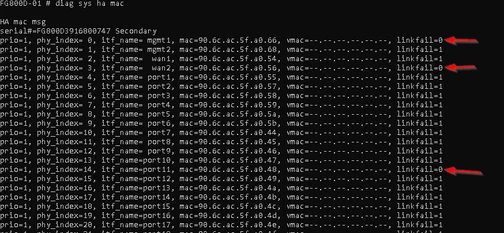

diagnose sys ha mac
Notice which interfaces are currently down (=1) and up (=0) on both cluster members.
In HA active-passive, if the unit is subordinate, it won't have vmac information until it is Primary.

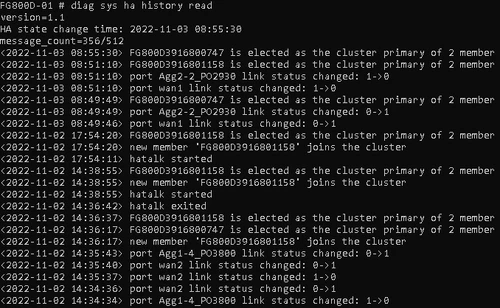

The 'diagnose sys ha history read' command will log the following events:
<timestamp> FG800D3916801158 is elected as the cluster primary of 2 member
<timestamp> user="admin" ui=ssh(10.10.10.1) msg="Reset HA uptime"
After cluster uptime is reset, it will show as zero for the reset unit and 'diagnose sys ha dump-by group' or 'dump-by vcluster' will show an incremented 'reset_cnt'.
'FG800D3916-----7': ha_prio/o=1/1, link_failure=50, pingsvr_failure=0, flag=0x00000000, mem_failover=0, uptime/reset_cnt=0/4
'FG800D3916801158': ha_prio/o=0/0, link_failure=50, pingsvr_failure=0, flag=0x00000001, mem_failover=0, uptime/reset_cnt=349084/1
