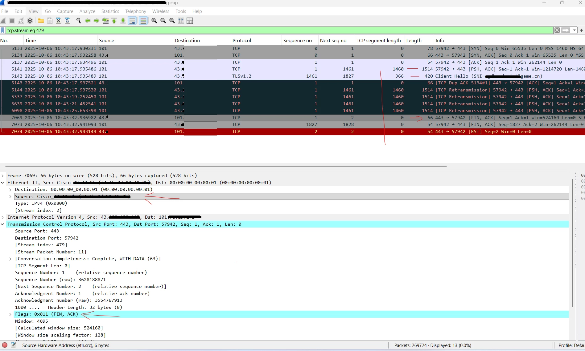

Before the change in tcp-mss-sender and tcp-mss-receiver values, the packet sniffer showed that there were only Client-Hello packets were sent out, and there were lots of TCP retransmission packets with their length bigger than 1500 bytes, which caused the connection error between source and destination:

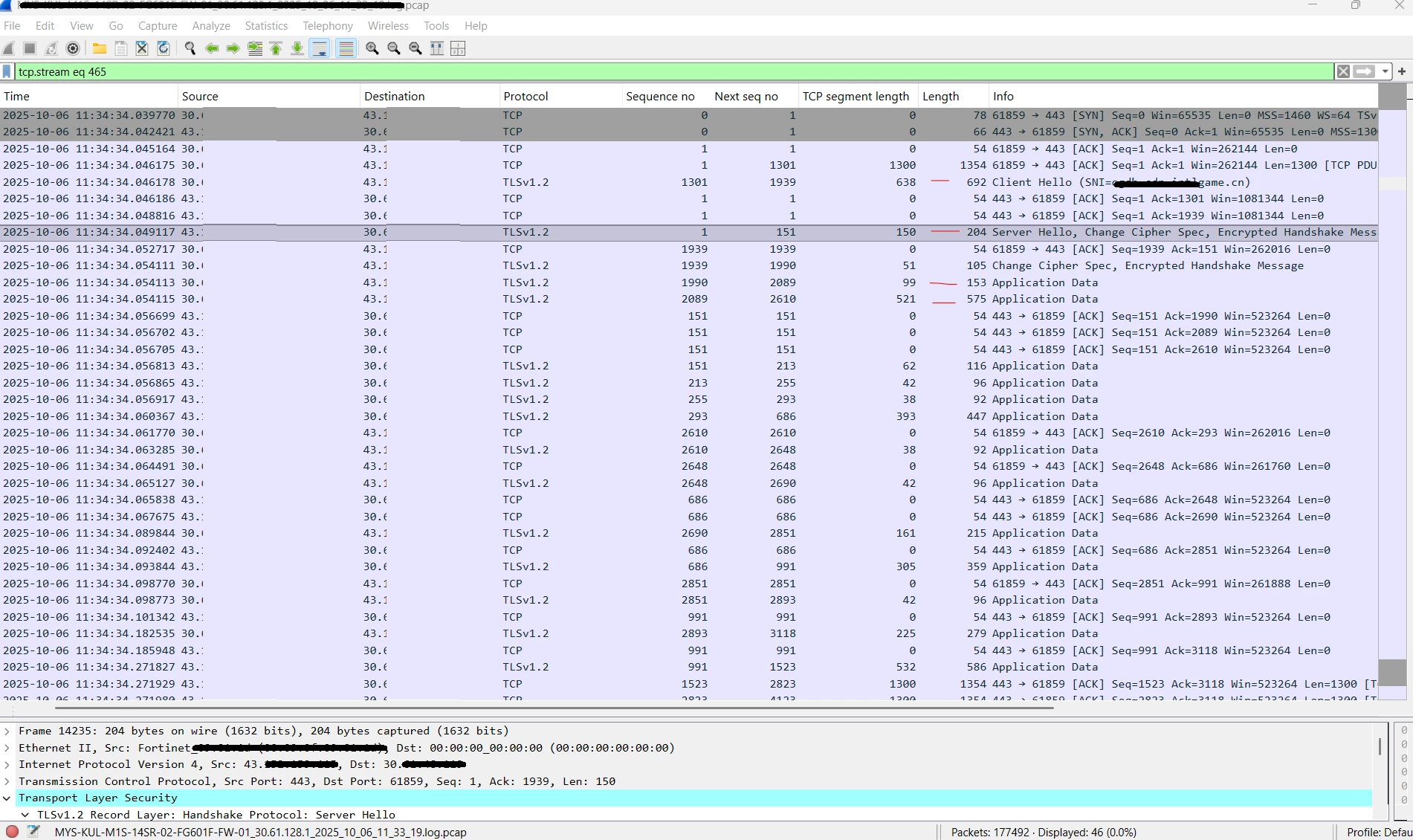

After reducing the tcp-mss-sender and tcp-mss-receiver values, the packet sniffer showed the proper TLS connection (including Client-Hello, Server-Hello, and Application Data) between source and destination, resolving the connection issue:
