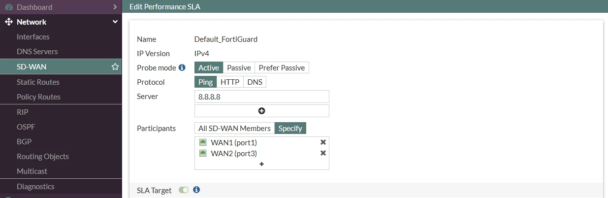

Description This article explains the different monitoring protocols that can be configured in performance SLAs when using active monitoring.
Scope FortiGate.
FortiGate can choose the best path based on protocol-specific data, enhancing load balancing and failover for key applications.
In the GUI, users can access only three monitoring protocols: Ping, HTTP, and DNS. However, additional monitoring protocols are configurable through the CLI:
