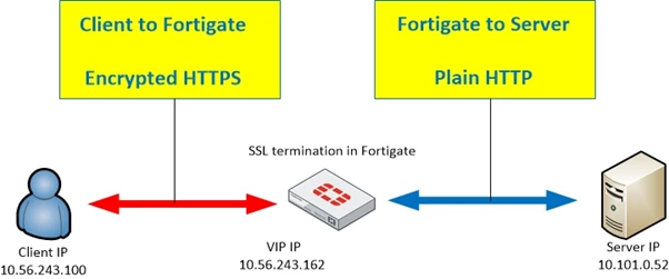

Diagram.
FortiGate SSL/TLS offloading is designed for the proliferation of SSL/TLS applications.
The key exchange and encryption/decryption tasks are offloaded to the FortiGate, where it is accelerated, using FortiASIC technology, which provides significantly more performance than a standard server or load balancer.
This frees up valuable resources on the server farm to give better responses to business operations.
Server load balancing offloads most SSL/TLS versions, including SSL 3.0, TLS 1.0, and TLS 1.2, and supports full-mode or half-mode SSL offloading with DH key sizes up to 4096 bits.
FortiGate SSL offloading allows the application payload to be inspected before it reaches the servers.
This prevents intrusion attempts, blocks viruses, stops unwanted applications, and prevents data leakage.
SSL/TLS content inspection supports TLS versions 1.0, 1.1, and 1.2 and SSL versions 1.0, 1.1, 1.2, and 3.0.
