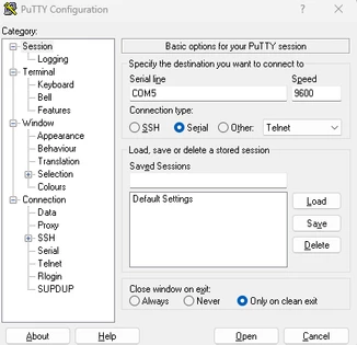

  • Console connection: Connect the computer directly to the console port using RJ45 to db9 cable or RJ45 to USB cable.
  • SSH access: Using Putty, put the IP of the FortiGate along with the port number.
After the above steps select open and log in using the admin username and password.
