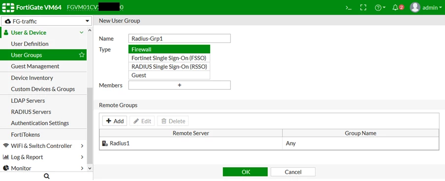

2) Designate a RADIUS server and create a user group.

From GUI.
- On the FortiGate, go to User & Device -> RADIUS Servers.
- Edit an existing server, or create a new one.
- If necessary, add a Name for the server.
- Set the IP/Name to 172.18.60.203 and Secret to 1dddddd .
- Configure other fields as necessary.
- Select 'OK'.
- Go to User & Device -> User Groups.
- Create a new group, and add the RADIUS server to the Remote Groups list.
- Select 'OK'.
