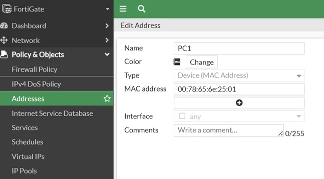

config firewall address
    edit "PC1"
        set type mac
        set associated-interface "port10"
        set macaddr "00:78:65:6e:25:01"

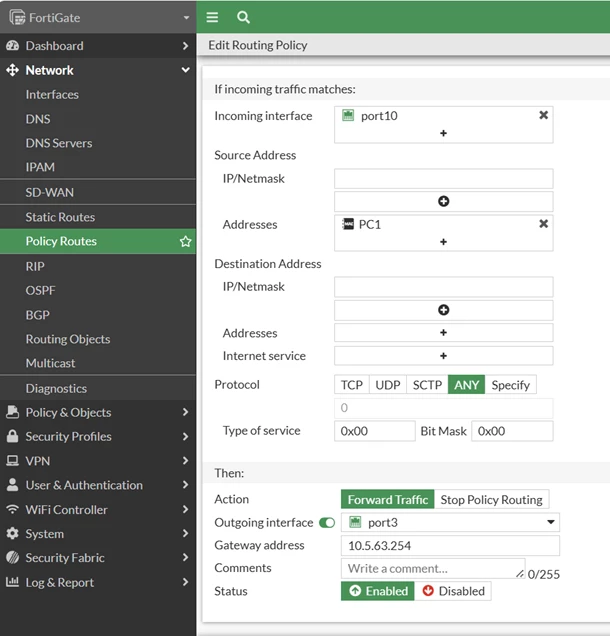

config router policy
        set input-device "port10"
        set srcaddr "PC1"
        set gateway 10.5.63.254
        set output-device "port3"
Below is the configuration via the GUI:
To configure the firewall address: Policy & Objects -> Addresses.
To configure the Policy Route: Network -> Policy Routes.
